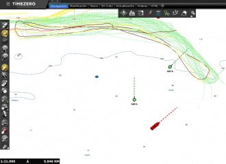

Подскажите кто то подключал ARPA через Lan радар фуруно, у меня только оверлей картинка но нет арпы

BobbyDigital,
I don't know what model of Radar you have.
But for the TTM to pass through LAN you have to configure the output.
2XX7 Configuration:
The ARPA target output must be setup through the LAN from one FAR2xx7. Hold “HL OFF” and press the “MENU” key 5 times. The “Initialize” menu appears. First, select “TT Preset” (6). Select “True” for “TTM Output” (2). Select “Back” to return to the “Initialize” menu and select “Other” (8). Set “INS” (5) to “LAN”.
TimeZero Configuration:
In order for the ARPA target to be received over the network, you need to configure it manually in the software:
Open the Connection Wizard
Select "Manual Port Configuration" and click on "Next"
Select "Add/Configure UDP Connection" and click on "Next"
Select the IP address that begins with 172.31.x.x from the "Network Adapter" drop down menu and type "10028" for the "UDP Port". Click on "Next"
When TimeZero is done analyzing the port, select “UDP 10028” in the list on the left and make sure that “ARPA” is checked in the list on the right. Click "Next" then "Finish".
