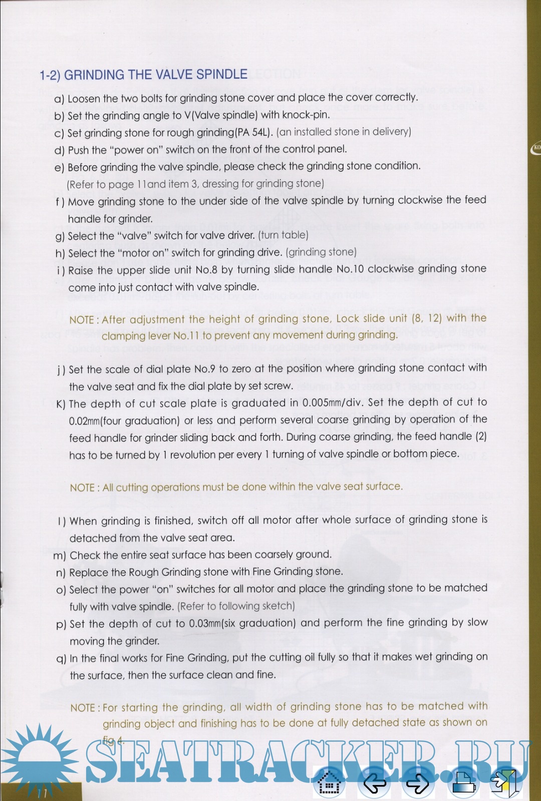

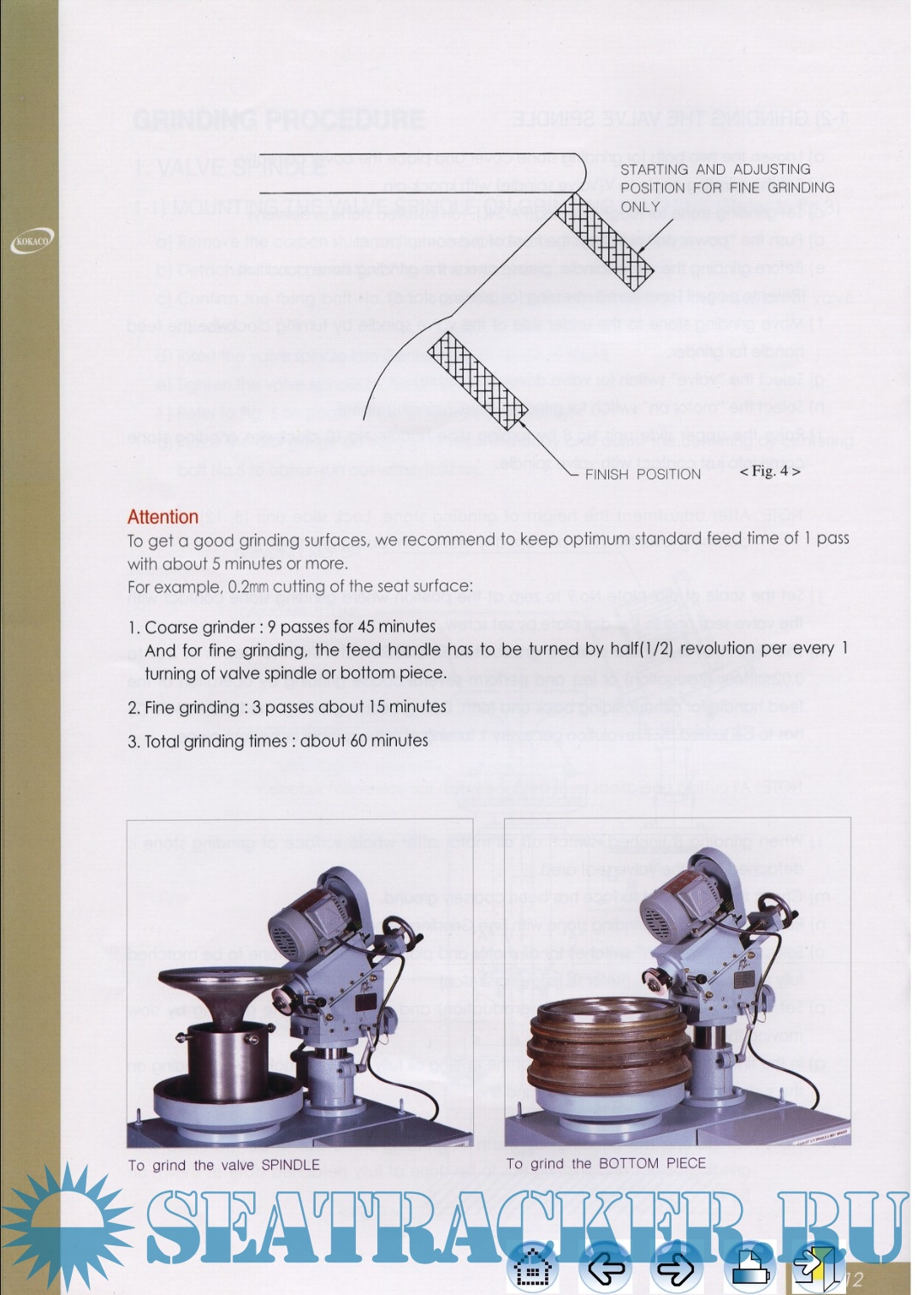

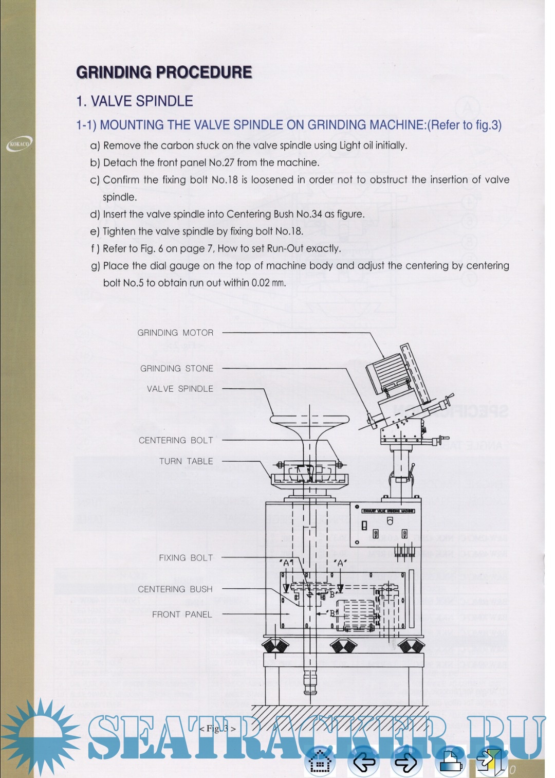

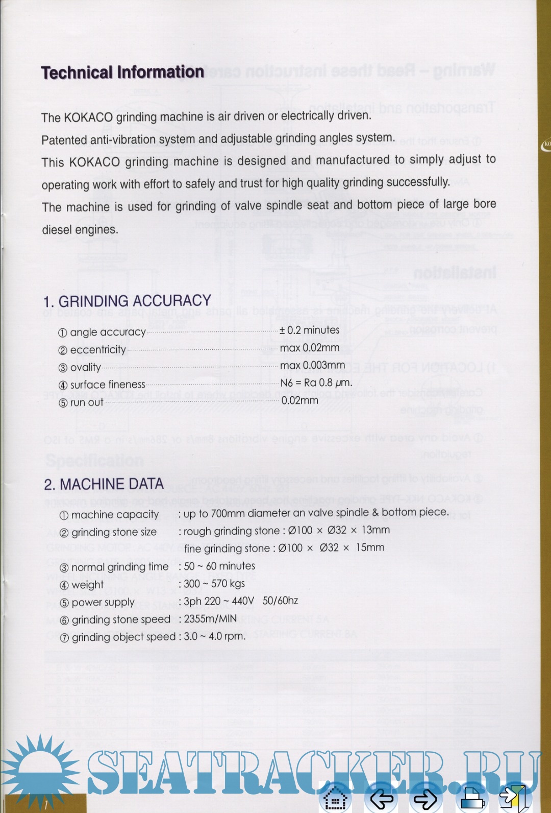

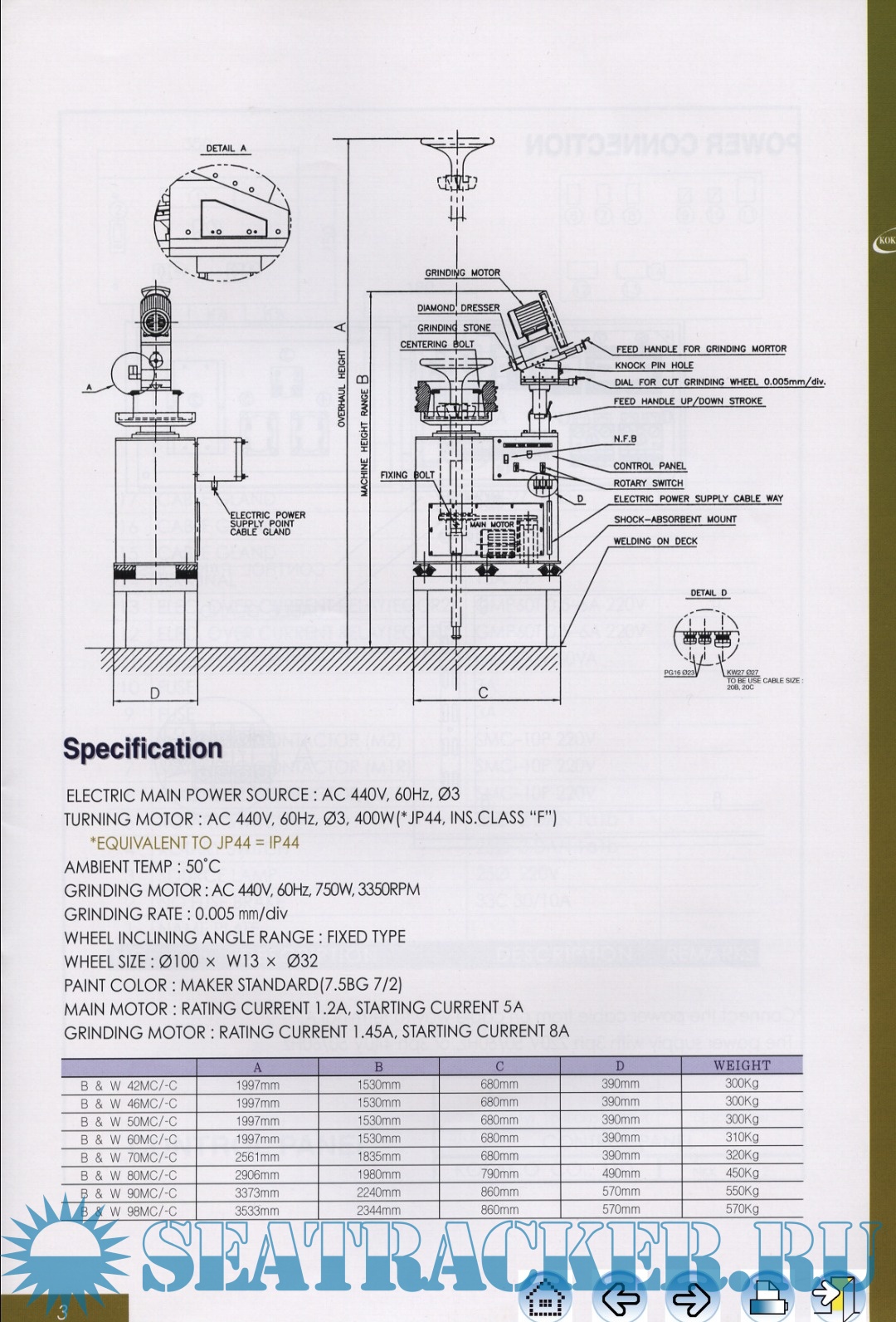

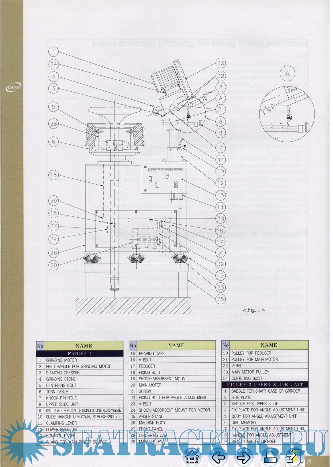

KOKACO System Exh' valve spindle & bottom piece grinding machine
Year: 2007
Author: KOKACO Co. Ltd.
Publisher: KOKACO Co. Ltd.
Pages count: 26
Description: The KOKACO grinding machine is air driven or electrically driven. Patented anti-vibration system and adjustable grinding angles system. This KOKACO grinding machine is designed and manufactured to simply adjust to operating work with effort to safely and trust for high quality grinding successfully. The machine is used for grinding of valve spindle seat and bottom piece of large bore diesel engines.
OPERATION MANUAL (MODEL NKK - TYPE).pdf
Download [10 KB]
